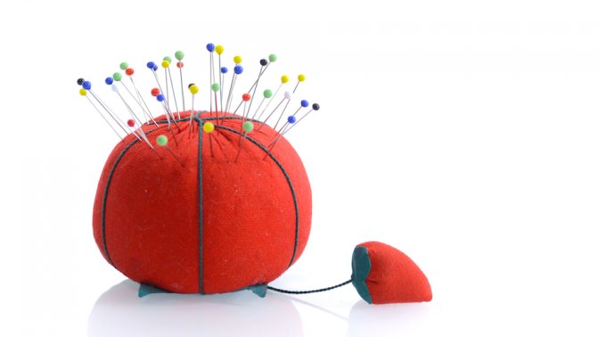

I tested in a similar way although I just ground down the + tip of my meter...I found pins a bit fiddly!
I use cushion pins to probe these connections:
